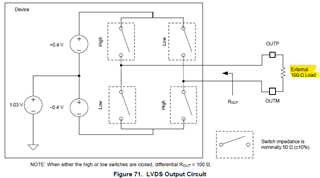

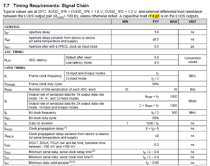

I am working with the ADS52J90 and connecting the LVDS to a SoM on another board.  I noticed the datasheet specifies a 4pF load capacitor between each output and ground. I am wondering where this value was derived from? Additionally, should this capacitor be placed as close as possible to the ADS52J90 LVDS driver or closer to the SoM?

    The 4pF load capacitor was just assumed as a typical trace-load during the LVDS characterization and hence mentioned in the spec table.
    However, it is not recommended to have such a load capacitance on the LVDS traces. You just need to end-terminate the differential traces with a 100-ohm as shown below. This 100 ohm should be inside (or as close as possible to) your SoC or FPGA.
