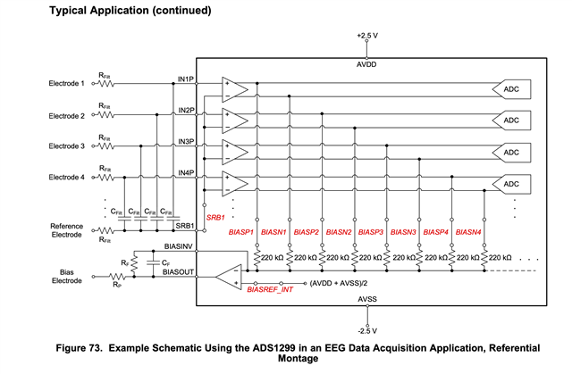

    What do you mean by "monopolar mode"?
    Could you refer to datasheet and specify whether it's  Sequential(i.e. differential) montage or Referential(Single End) montage?

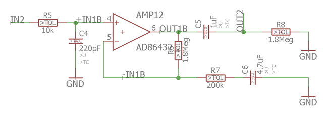

    Would you mind sharing portion of your schematic?  If not allowed, I can reach out to you via email.

    1. The phrasing Monopolar relates to connectivity method as described in the datasheets of the ADS1299 on page 67 (See Fig below)
    2.PreAmp was added because we use dry electrodes (Silver metal) and I understand that PreAmp increases the input impedance near the electrode (the pre amp is located very near the electrode).
    I will appreciate your review on the peramp design.
