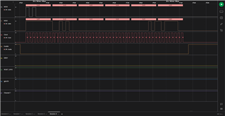

  • Hello, good evening. I thank you for responding. I'm attaching my signals after the first capture. The enable signal is correct; I was only able to plot 4 signals, so I didn't include the enable signal in the graph, but I confirm that it's correct
    Detail from +90us to +40us:
    I'm only transmitting, and the responses are from the ADS. But after sending the data, I read the number of bytes I sent (described in detail from +2us to +5us)
    Detail from +2us to +5us:
    This is my current code; I implemented interrupts as in the example on pages 93-94 of the datasheet

  • Hi ,
    It is not easy to check your timing. Below is a timing example captured on ADS131M04 for reading CFG register(0x06 address) which was already written 0x0700 to enable Global-chop mode with a default delay in the previous step. As you can see, the register data (0x0700) was successfully shifted out on DOUT line in the 2nd frame without checking and waiting for /DRDY signal.
    Could you please show me your timing like this so that I can easily read the data?
    When you connect 3v3_lp on the EVM to the 3v3 power pin on your Raspberry Pi , dii you have a jumper on JP12 to short pin 1 and 2 of JP12? Also, did you provide any power to DVDD of the ADC on the EVM?
    Dale

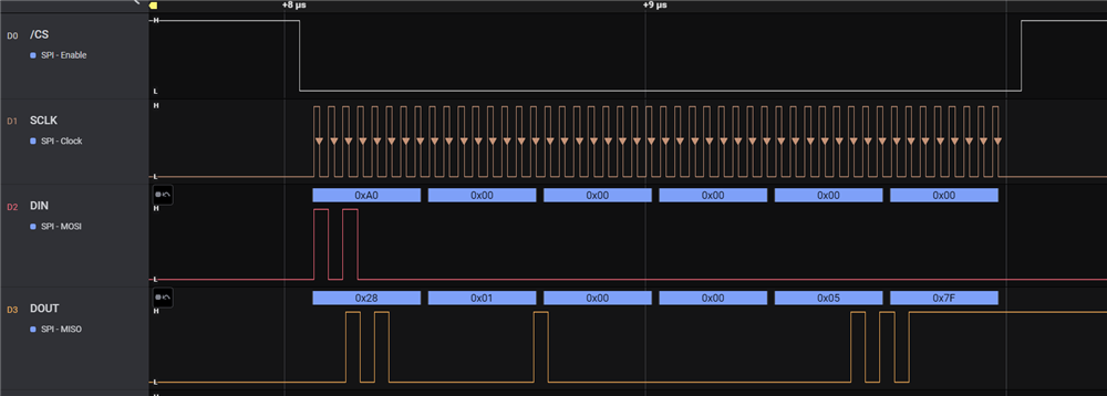

  • Good afternoon! I'll detail the updates I've made. I modified my code to use only pigpio on my Raspberry Pi 4B in order to achieve a better clock and timing precision. I configured the SPI frequency to 2 MHz; I'm not certain if this frequency is correct. The datasheet specifies a maximum SPI clock frequency of 25 MHz, but it doesn't mention the minimum frequency. What is the known minimum frequency at which the ads131m08 can operate?
    I'm using a simple 8-channel 25Ms/s logic analyzer. Due to this, I'm using a frequency of 2 MHz and I want to confirm if it's correct.
    I edited my code to read the ID and STATUS registers, as well as to read all channels of the ads, implementing the timing described in this link: ADS131M08: DRDY not going low - Data converters forum - Data converters - TI E2E support forums
    ADS131M08EVM Power Supply: I made the external power supply connection based on this note from the datasheet:

    Attached are the temporal graphs you requested.
    Temporal Timeline Graph - Reading ID Register
    SECOND SAMPLE:
    Temporal Timeline Graph - Reading STATUS Register
    SECOND SAMPLE:
    Temporal Graph Reading All ADC Channels
    SECOND SAMPLE:
  • Hi CELESTE GONZALEZ CANTERO,
    When your SCLK frequency is 2MHz, one clock period is 0.5us. If you want to read the data of all channels and your data size is 24 bits, one cycle has one STATUS word+8 channel data + CRC word, the minimum time for one cycle is (1+8+1)*24*0.5us=120us, so your data rate should be limited to 1/120us=8.3ksps (other delays are ignored).
    It's very hard to see your timings except the 1st timing. Your command to read ID register is correct, your should be able to get the data of ID register in the 2nd frame, see my timings below that were just captured on the M08EVM. 0x2801 in the following 2nd frame is the data of ID register from M08 ADC.
    1st frame to read ID register:
    2nd frame to read ID register:
    I could not clearly see your timing to read the STATUS register which has an address 01h, however it seems that your were sending 0xA001 command to the ADC, this is incorrect, the correct command is 0xA080. Please double check your command.
    By the way, if the input CRC is disabled (default), you only need to send 24 SCLKs to read a register from the ADC instead of 48 SCLKs and also you only need to send NULL (all zeros) in the second sample/frame. See my timing in my previous post.
    I could not see the details in your timing to read data of all channels, so I could not check it.
    Dale
