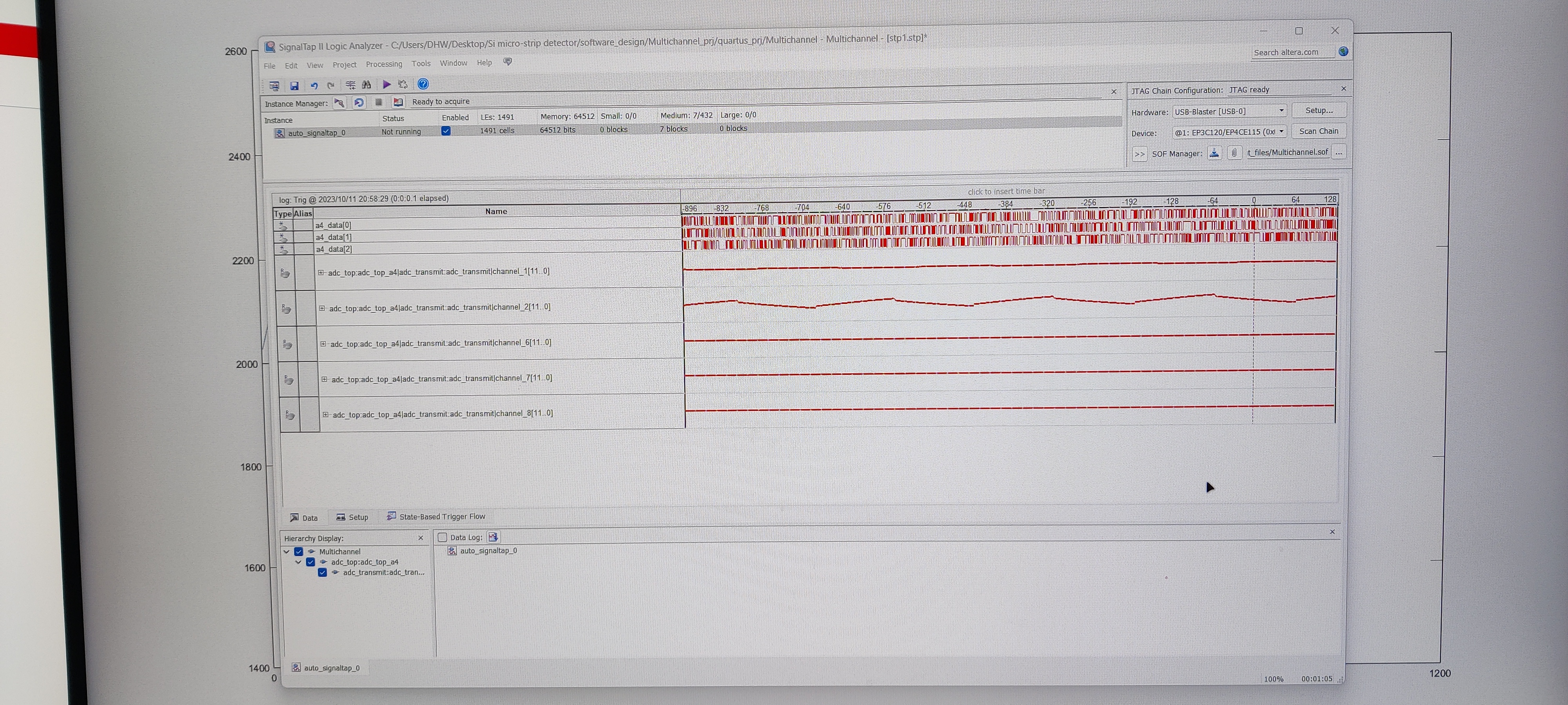

A 200-kHz, 200-mVpp square wave generated by the signal generator couples a sine wave of the same frequency into the waveform output from the AFE5801. The customer would like to know how to remove this sine wave?

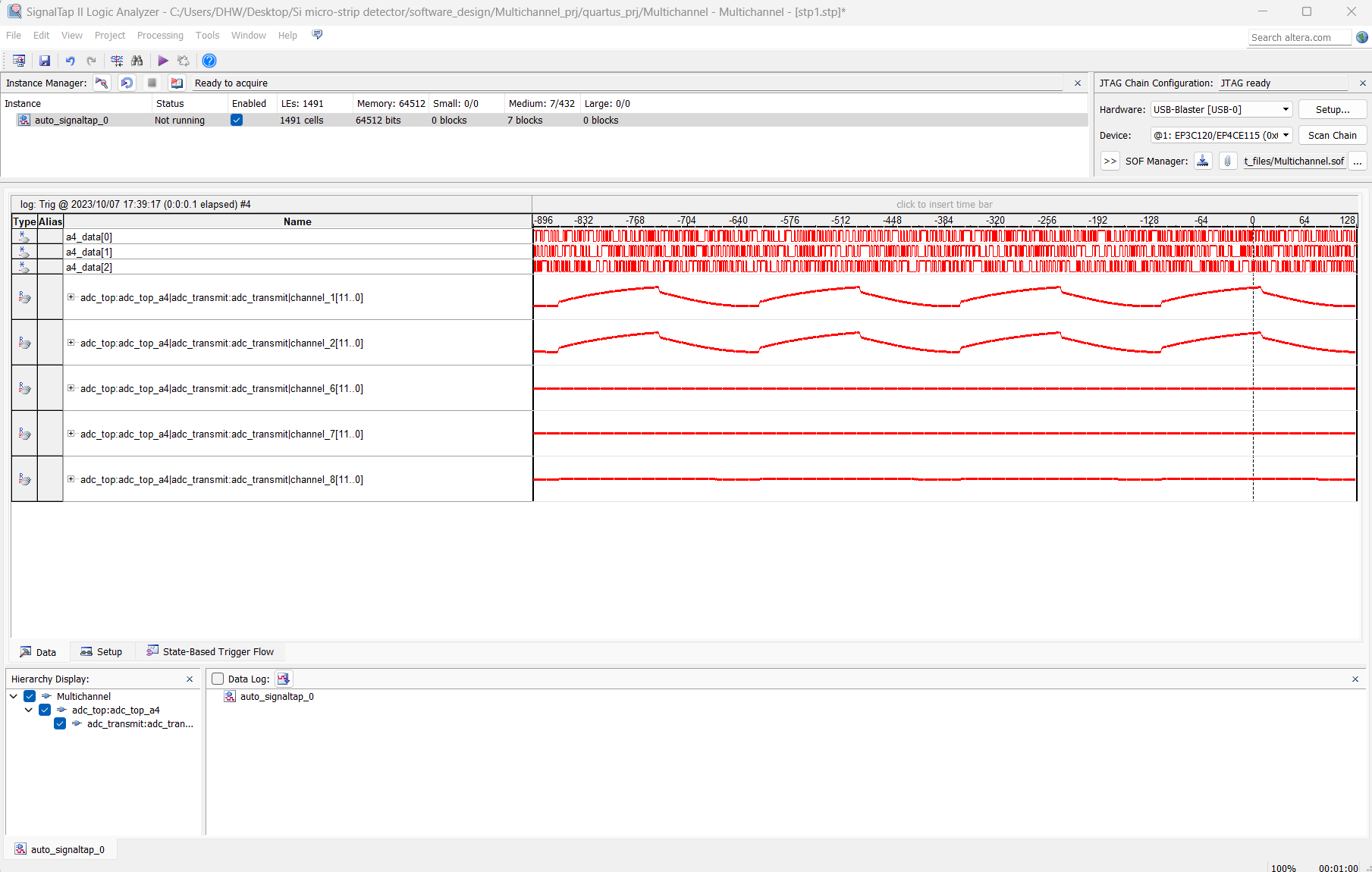

The signal takes a single-ended input and is AC coupled into the 5801 with a sampling rate set to 50 MHz. The waveform being picked at SignalTap is shown in the following figure, with the signal on channel one and channel two:
The output is set to unipolar output with register address 0x04[3] of 1. The customer has tried an LVDS test and receives a ramp output with register 2[15:13] of 111. Low-noise mode is enabled and register 7[10] is 1.

    Did customer probe the input of AFE and confirm if same kind of signal is seen at the device input too? I am thinking that input is proper and due to third order LPF in the device, the output is looking like above picture.

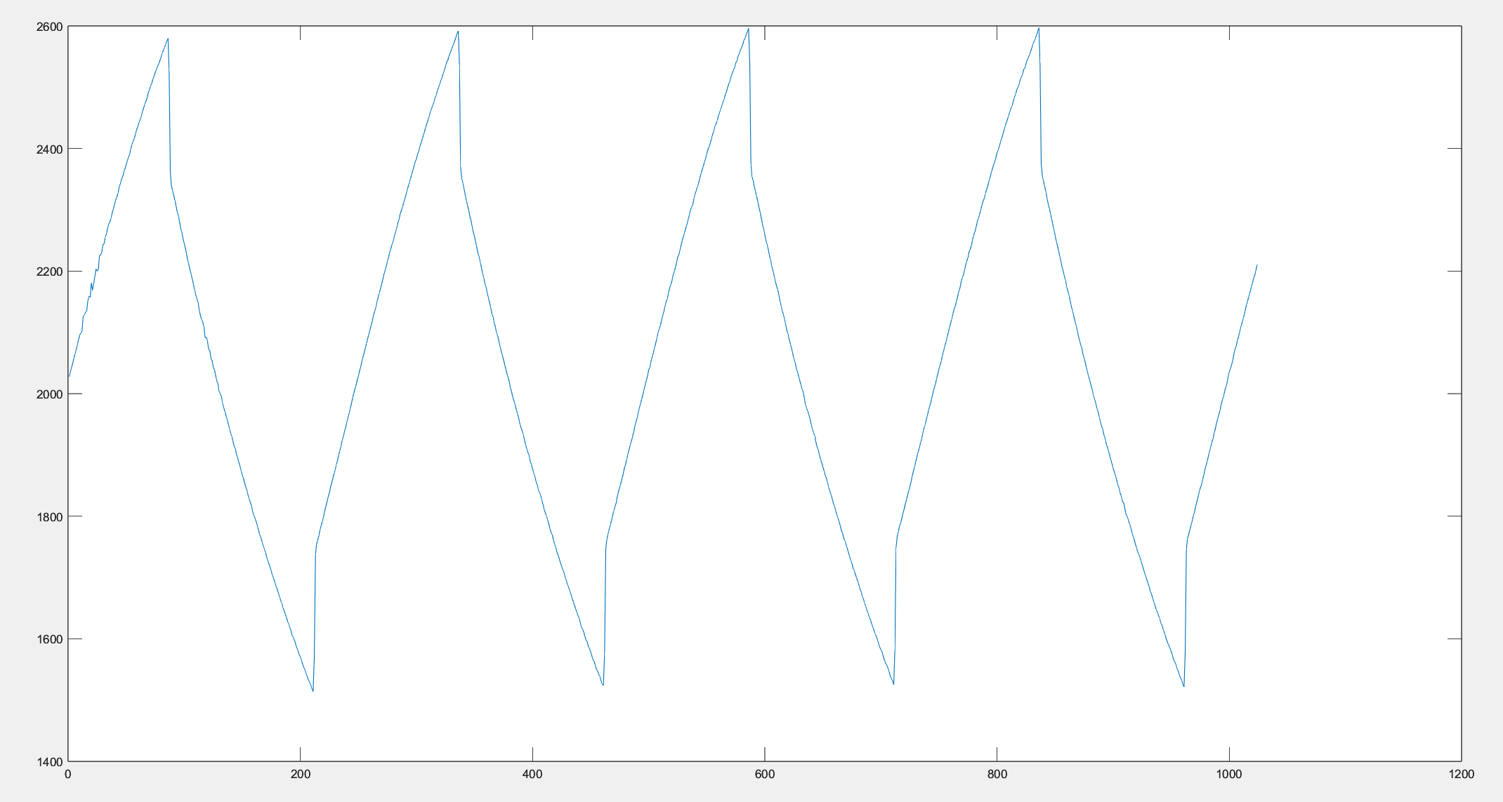

    With the device low pass filter disabled, that is, the register address 0x07[3, 2] is set to 11, but the issue remains unchanged. The customer tested the input of the AFE and the measured waveform was a 200-kHz, 200-mV square wave, as produced by the signal generator.
    Here is the waveform after the data is imported into the matlab, and you can see that one other waveform is overlaid in the square wave:

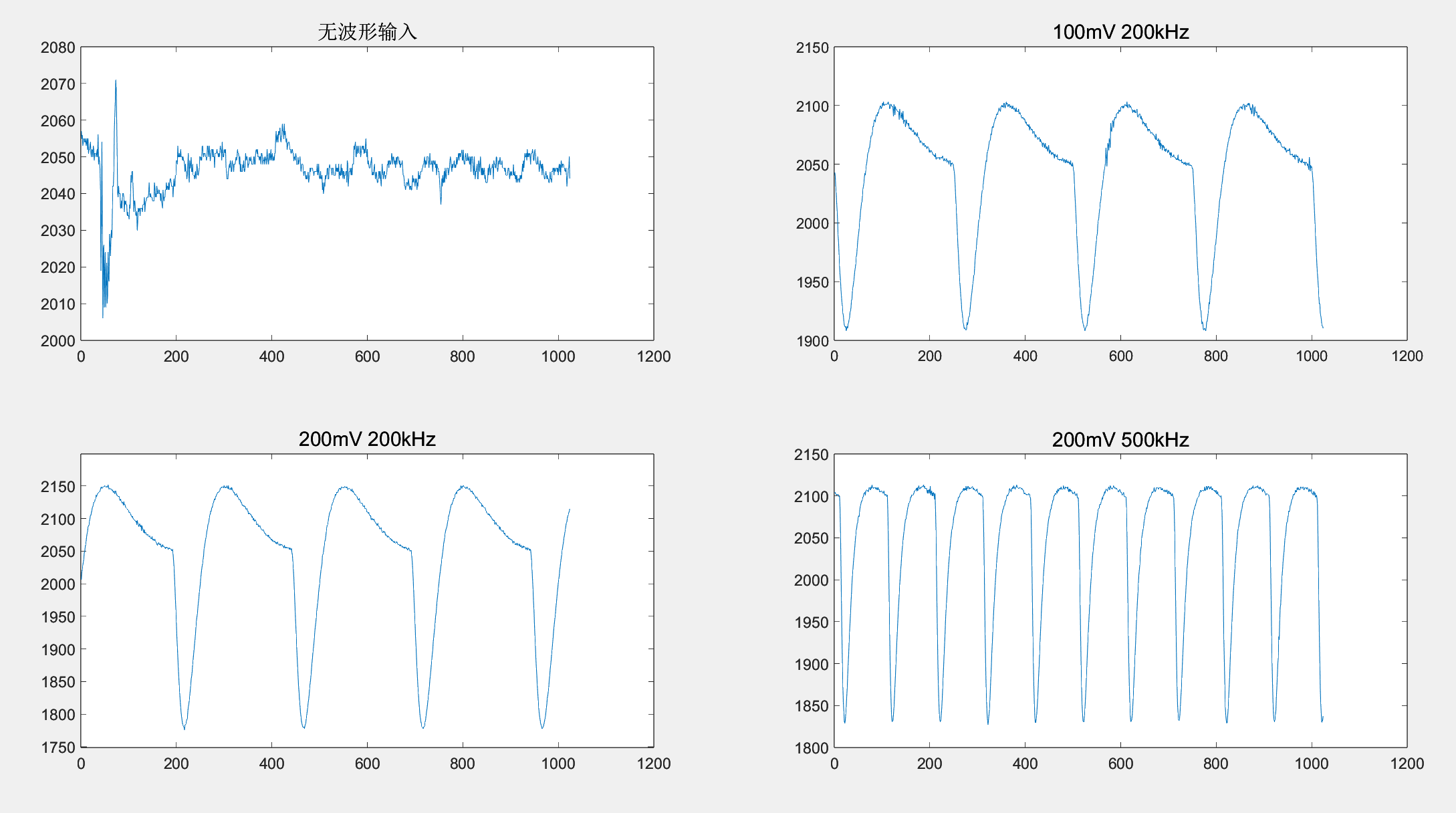

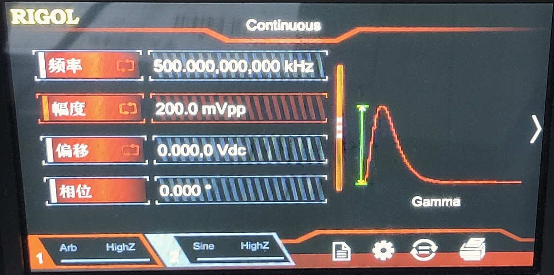

    Since AC coupling is used to emulate a signal single-ended input, INP is connected to the signal source, and INM is connected to AGND through 100 nF. The square wave signal cannot be AC coupled in its peak valley, so change the test waveform to Gamma waveform as shown.
    The AFE output waveform was tested at 100 mV/200 kHz, 200 mV/200 kHz, and 200 mV/500 kHz without waveform input.
    As you can see from the above testing, the waveform should have flattened at 2048, which is 0 of the ADC range, but all three sets of tests have varying degrees of overshoot, where 200 mV overshoot is larger than 100 mV at 200 kHz, there appears to be an internal capacitor being discharged, and oscillations with no waveform input are also coupled in the overshoot portion.
    At 500 kHz, the capacitor discharge should have welcomed the next waveform before it is finished, so it does not overshoot to 2150 at 200 kHz, but it goes to the next waveform at 2100.
    The customer would like to know how to make the acquired waveform the same as the incoming waveform? (Internal AC/DC register is set to DC, register 0x07[1] = 1)

    Thanks for the details. From here I see two possibilities.
    - Either this phenomenon is happening due to single ended input OR
    - There is unintentional HPF.
    One possible reason for HPF could be the INP/INM network. Is it possible for you to increase both INP and INM cap to 1uF and check the response at 200kHz?
    Can you convert the signal to differential using transformer and feed the differential input to the device?
    If you can try above two experiments then it will helpful.
