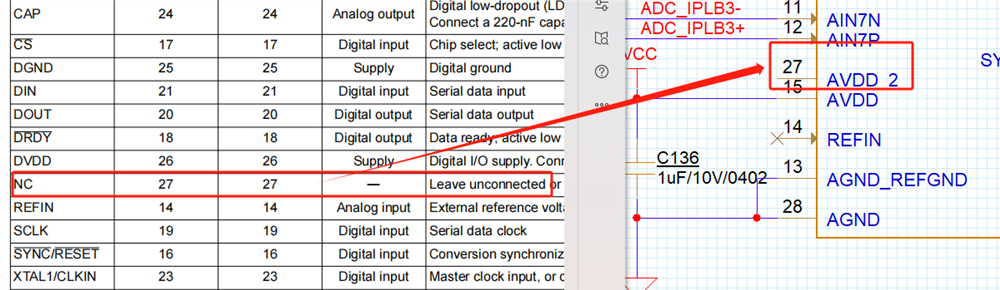

Hi  TI
      Why is the 27pin inconsistent with the manual?

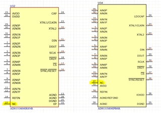

  • Hi Rain Wang,
    I'm not sure why you are seeing an error, but in my PCB editor both packaged versions of the ADS131M08 pin 27 is labeled correctly as NC - see below.
    Can you manually change this pin in your PCB editor to be NC? I know this option is available in Altium.
    Or, you can just connect this pin to AGND or leave it floating, as per the datasheet
