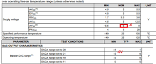

Customer is looking for PA monitor solution and to do temperature compensation. There are three PAs in that chip and need power up sequence.
VG1/VG2/VG3 supply -5V--> VDD1/VDD2 supply 50V --> VG2 to -6V --> VG1 to about -3V to make Ivdd=40mA--> VG3 to about -3V to make Ivdd=130mA
Also need provide consistent Idd when Vdd changes.
We are considering AMC7834 but wondering if it can meet the requirements? Cause the AVss and DAC output range of AMC7834 can down to -5V only but they need -6V instead in this case.
If AMC7834 is not suitable, could you please advise other suggestions?
