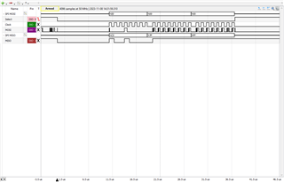

Attached here also the screenshot of the logic analyser's output (where the addresses and values are not coming out accurate, for some reason)
Please let me know why this issue is occuring.

    Can you remove the jumper on J11 and write only the command to power up the internal reference. Please also measure the SPI signals during that command with a scope and share a screenshot. Check the REF pin to see if the internal reference powers up. If this command is not being seen correctly on the scope then there could be a problem with your SPI library that you will have to debug first. You can also measure the SPI signals without them connected to the EVM to verify that they have the right format first.

  • Hi Lalita,
    Just to confirm, are you able to toggle the reference and see the 2.5-V on J1.7 go on and off if you write multiple commands to set bit 14 in GEN CONFIG to 0 and 1? Your screenshots don't really convey that the right command is being sent, but it will be good to know that you are able to control the reference. It would also be helpful if you could annotate the screenshots with what command is being sent. Right now, I don't want to look at the MISO (SDO - serial data out from the DAC) line until it's been confirmed that you are able to write to the DAC successfully through the MOSI (SDI - serial data in from the DAC) line.

  • Hi Lalita,
    So from this it seems like you SPI writes are not working. Can you write the following commands and send another screenshot of each command with the SCLK and SDI pin shown on the scope and SCLK, SYNC, and SDI shown on the logic analyzer? Try to zoom in so the write takes up the whole window in each screenshot (SYNC falling edge to SYNC rising edge).
    register 0x03, data 0x0040
    register 0x04, data 0x0000
    check reference level
    register 0x04, data 0x0400
    register 0x05, data 0x5555
    This last command is just to help us see that your controller is sending the right data. The SDI pin should be toggling low and high on each clock to send data 0x5555.
