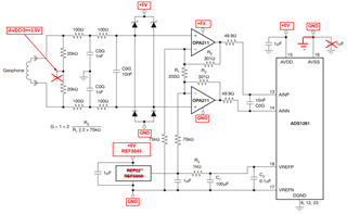

Can 1281 be powered by a single supply, such as AVDD=5V, AVSS=GND, VREFP=4.096V, VREFN=GND. If possible, is the analog input range still from VREF/2 to - VREF/2? At this time, can it be from positive 2.048V to negative 2.048V?
Hello Jiang,
Yes, the ADS1281 can be powered from a single supply as you have described. Below is a marked up Figure 56 from the datasheet that shows how to do this.
You can still get the full +VREF/2 to -VREF/2 range, but the input voltages relative to ground (DGND=AVSS) must now be offset by AVDD/2=+2.5V.
For positive full scale, +2.048V differential:
AINP=2.5+1.024=3.524V
AINN=2.5-1.024=1.476V
Vin-diff=AINP-AINN=3.524-1.476=+2.048V
For negative full scale, -2.048V differential:
AINP=2.5-1.024=1.476V
AINN=2.5+1.204=3.524V
Vin-diff=AINP-AINN=1.476-3.524=-2.048V
In all cases, the voltage on the inputs referred to DGND=AVSS must always be positive, but the differential voltage can be positive or negative.
