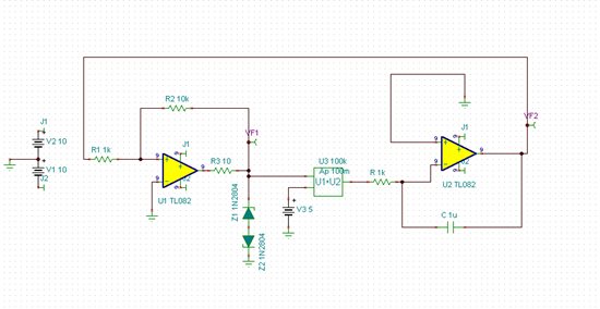

I am working on ALSKv2011 trainer kit provided by Texas to our college.

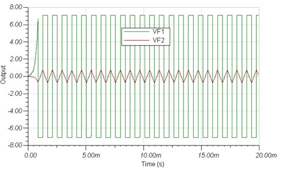

In experiment no 6 ie Voltage controlled Oscillator i am getting the desired amplitude and frequency but my output duty cycle is not 50%.
i am getting around 64%(ie UTP>LTP) duty cycle.
1.changing any values of R and C will only vary amplitude and/or frequency.

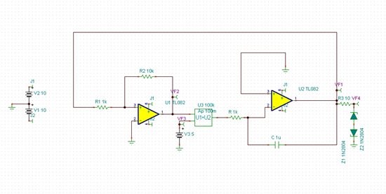

2.adding a voltage follower in feed back network is also not solving the problem.
3.i am getting 13 V p-p as output of my schmitt trigger.
4.i am not facing any problem if i use the integrator circuit of VCO.
5.Each part(schmitt trigger, multiplier and integrator) of the circuit individually is giving 50%
please give any solution to reduce the duty cycle to 50%
