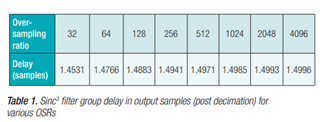

I read below article. Could you provide the delay table for ADS131B04-Q1?
https://www.ti.com/lit/wp/slyy095a/slyy095a.pdf

    The delay number in that table includes the delay from the delay introduced by the SINC3 digital filter, but also the delay from the digital logic. For ADS131B04-Q1, it has the same SINC3 filter, so the delay from the SINC3 digital filter can be got from the table 1 in the app note from the link in your post, the delay time can be calculated from the number of samples and the data rate. However, we do not have a data for digital logic and capacitive gain on the ADS131B04-Q1 ADC.
