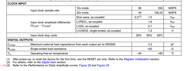

Part Number: ADS42JB69
What is the minimum input clock voltage (the datasheet does not specify in table 7.3)?
LVPECL has a nominal ac-coupled amplitude of 1.6V, but what should I consider the minimum amplitude to be?
Hi SRB,
The clock amplitude spec is a bit arbitrary.
Use the AC coupled input sinewave specs. Then see the datasheet footnote.
You can refer this level to the PECL standard.
Rob
