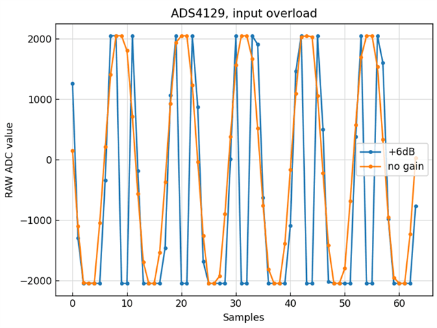

ADS4129 behave as expected by clipping data on input over-range accordingly to the side of event.
It sticks to 1FFFh/2000h in case of top/bottom overload in two complement format.
To my regret, I discovered that the expected clipping does not occur when using (digital on chip) gain.
The problem occurs at any gain level while the gain path is enabled. Even at +0db
Is this a known issue? are there any suggestions for resolving it?
