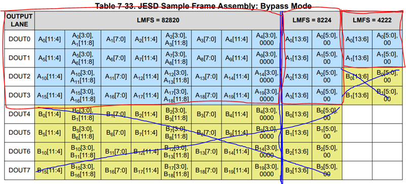

    I am not sure I follow. If we just ignore all of the channel B jesd lanes and only consider channel A lanes, still, if the number of serdes lanes decreases then the datarate will typically increase if the resolution remains the same. Let's just consider how ignoring channel B would act for bypass modes. For bypass mode, the ADC has these options for frame format:
    If we ignore all channel B data (yellow), then these new frame formats would change into (left to right):
    • LMFS = 4-1-8-20
    • LMFS = 4-1-2-4
    • LMFS = 2-1-2-2
    The number of lanes (L) is reduced as well as the number of converters (M). The number of octets in a frame (F) and number of samples per converter per frame (S) will stay the same.
    This device does not have a one register setting to powerdown channel A or B, however the customer can powerdown unused lanes to save power.
    Thanks, Chase

  • Hi Kei-san,
    The most efficient data packing is already present because there are always modes present where the data is not interleaved.. See below.
    If we consider the customer wanting to use 1-4-8-1 and then eliminate the second channel to half the M, the result would be half of the frame being empty. So instead, they could use 2-4-4-1 and then only take lane 1 to get the high efficient data for channel A alone.
    Thanks, Chase
