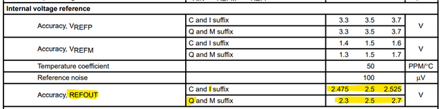

Recently we received the notice that THS1206IDA will be obsolete soon, so we are checking the replacement for this part.
We found that THS1206QDA is still active and with extended operating temperature range, but the tolerance is worse than THS1206IDA, the tolerance of REFOUT is 8% , while it's 1% for THS1206IDA. We'd like to know what cause this difference?  If it is caused by temperature rise (85C -> 125C)? In other words, If THS1206QDA only works under -40 to +85C, can the REFOUT tolerance be 1% same as THS1206IDA?
BTW, do you have the data or curve for REFOUT under different temperature?
