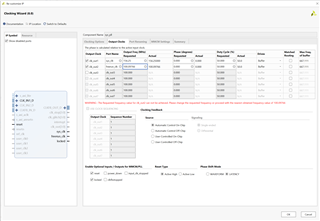

2. PLL Could not generate exactly 100MHz so, changed to 100.09766MHz. DRP clock also set on the same frequency
3. Created a timer to generate the synchronous resets instead of VIO, triggered from QPLL0 lock, and activated at around 4.5uS
4. Set the cfg_rx_buffer_release_delay to 10 (arbitrary)
PLL Warning for 100MHz Clock:

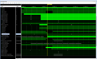

I see GTH activity prior de-asserting the Tx Sync Reset, but values are fixed (0xFF00 pattern)
Tx seems to start normally at approx. 4.5uS (see cursor on above screenshot).
Rx shows that lanes are locked at about 6uS.

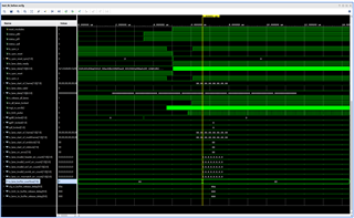

Rx_lane_data_valid is never active and I see overflow error after a while, as per below screenshot.
Can you help me to determine why the receiver is not getting any data?

    The steps that you have followed look correct, but I see that the cfg_rx_buffer_release_delay is set to 0xA. Please try the simulation with a value of 0x0 and let me know if you see the Rx link working properly. In addition, please let me know why the release delay was set to 0xA. The procedure to setting the value on this input is described in the deterministic latency section of the user guide.
    Ameet
  • Dear Ameet,
    This resolved the problem and the ADC received the data.
    Regarding the cfg_rx_buffer_release_delay, I just set a small non-zero value for safety purposes - didn't think that this would have any significant impact. My design does not require deterministic latency, anyway.
