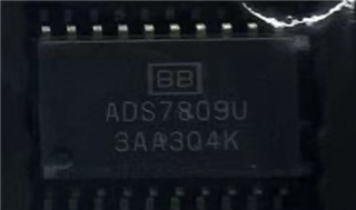

Hi
Could you please help confirm why this physical marking is inconsistent with the datasheet marking, with a letter B missing
Thank you

Hi yingjiao,
I am checking with team about the top marking on this device since I just knew there was a change recently. I will probably get it back to you early next week. Thanks.
Dale
Hi yingjiao,
I would correct my feedback after I double checked with my colleagues. Both have topside symbolization of “ADS7809U”. The outer packaging for ADS7809B should still carry the ‘B’, but the individual chips do not. This was a change around one year ago.
Dale
Hi yingjiao,
You can see the difference (B or regular version) on outer packaging but you can not distinguish whether it is "B" or not just from the top marking of chip. Both ADS7809UB and ADS7809U has the same top marking (ADS7809U) on physical chips.
Dale
Hi yingjiao,
As I mentioned, both versions are still available, no change for that.
