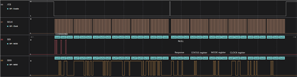

  • Hi Dale, I've just added to the post the full sequence in a pdf file.
    Andrea.
  • Hi Hi Andrea,
    Thank you for your patience.
    According to the ADS131M0x data sheet, the register data will be shifted out from the ADC in next frame, so you should not keep sending RREG command in every frame. Below is the timing I just tested and captured on ADS131M04EVM which is a 4-ch ADC in the same ADC family. The command (0xA082) to read 3 registers starting from address=01h was sent to the ADC in the 1st frame, then NULL (no operation) commands were sent out in the 2nd frame. As you can see from the timing, the correct register data were received in the 2nd frame. This timing was continuously repeated for 4 times for test purpose and no any issue was observed, the data of three registers received in the 2nd frame were always correct. You should be able to get a correct response from the ADC as long as you use the same timing.
    Dale
  • Hi Dale,
    Thank you for your analisis!
    This will confirm what I've seen: consecutive RREG cant' be used, the ADS will ignore the second RREG and replay as NULL command instead.
    This aspect sould be clearly written on datasheet; it is not related to when new data is it available for shift register, the second command is always ignored and STATUS with CHANNELS DATA will be supplied instead, even if there is no new data (DRDY0,1,2 on STATUS are at "0").
    Thanks Again.
    Andrea
  • Hi Andrea,
    Since the ADC will shift out the data of registers in the 2nd frame, it will think your each frame is the 1st frame if you keep sending the RREG command to the ADC, so the 2nd frame without a RREG command is expected for the ADC to shifted out the data. We will try to clarify it in next revision of the datasheet.
    Thanks&Best regards,
    Dale
