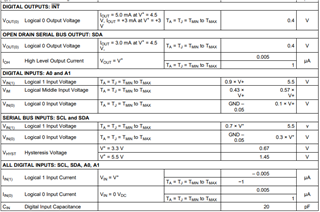

HI,
For ADC128D818CIMTX/NOPB, our V+ is 3.3V
But can not find VIH/VIL/VOH/VOL
Please help to check it, thx
HI,
Hi Lee,
Thanks for your question. The closest values defined for this part is as shown below:
Samiha
