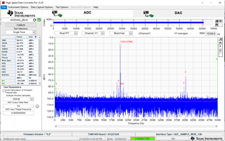

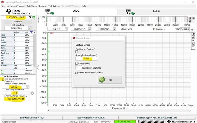

I am using the TSW1400EVM with the ADS5400 EVM board for measurements. While using HSDC Pro v15.15, I encountered the following error message: "No firmware. Please select a device to load firmware into the board." Below are the detailed steps of my operation:
  1. Downloaded HSDC Pro v15.15 from your company's official website and installed it on a computer running Windows 10.
  2. Connected the TSW1400EVM to the ADS5400 EVM board using the LVDS interface.
  3. Connected a 5V (4A limited) power supply to the TSW1400EVM and a 5V (1.5A limited) power supply to the ADS5400 EVM board.
  4. According to the data sheet, connected the appropriate clock signal and input signal to the ADS5400 EVM board.
  5. Connected the TSW1400EVM to the computer via the USB port, started HSDC Pro v15.15 on the computer, successfully connected to the TSW1400EVM after the Select Board interface appeared.
  6. After the Select Device interface appeared, selected "ADC."
  7. Chose "ADS5400_1BUS" from the Select ADC menu in the top-left corner of the GUI. After selecting, a prompt appeared asking, "Do you want to update the Firmware for ADC," and I clicked "Yes."
  8. After downloading for several seconds, the error message "No firmware. Please select a device to load firmware into the board" popped up.
I would like to inquire whether there is an error in my operating procedure or if there is a solution to the issue I encountered. Any guidance or assistance you can provide would be highly appreciated.
