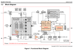

I'm designing a 4-20mA loop-powered receiver that also needs to communicate as a HART device.
Since I am powering off the loop, I'm planning on having a series of diodes to get a fixed voltage drop across the 4-20mA terminals. Something in the range of 6-8V. I'll then have a small sense resistor (10-50 ohm is what I'm planning) in order to read the analog input signal.
The issue that I'm trying to solve is how to make this work without a purely resistive input on the loop. Will tying the MOD_OUT and MOD_IN to the positive side of this diode network work? I don't anticipate any issue on the receiving portion but the transmission portion is where I have concern.
My input/power circuit will be similar in concept to this app note block diagram from TI:
Thoughts are appreciated!
-Brian

  • Brian,
    Some of that may work, but there are some problems with what you are describing.
    First, I don't think the diode stack would be a problem. If you have current running through it, the diode stack would basically be at a constant voltage, while the resistive load would show the FSK signal as the current is modulated through the resistance.
    However, the resistive load would need to be amplified a little. The HART signal is a 1mApp sinusoid, so with a 10Ω resistance, that's 10mVpp. It would need to be capacitively coupled to a gain stage and then sent to the MOD_IN of the DAC8740H. The device receives a HART signal that is greater than 120mVpp.
    For transmission, you would need to create some sort of circuit to modulate the current through the loop. You can't just connect the MOD_OUT signal directly to the bottom of the resistor. If you look at the DAC8740H datasheet, you can see a schematic that combines a DAC output that sets the 4-20mA current and combines the modulated signal from the DAC8740H on page 34, Figure 35. The DAC output and the MOD_OUT are combined with a summing circuit. This circuit is for a transmitter, but I would guess that the receiver would be similar, and you'd need to set up a current source to pull the sinusoid current from the resistor.
    I'm not sure if this will help, but I did write an app note on the basics of the HART protocol. Here's a link for the note:
    https://www.ti.com/lit/an/slaaeh0/slaaeh0.pdf

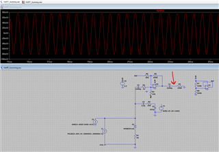

    I put together a quick spice simulation of the transmission side (with some small differences than mentioned above) and I'm seeing the expected ~1mApp wave through the sense resistor. Using a resistor on the DAC8740 side of things. Am I missing something or would this setup work for the transmission side?
    Edit:
    I went ahead and simulated the MOD_IN side of things as well with a different simulation. If I amplify the input as shown, I'm seeing approximately +/-80mV (160mVpp) at what would be the input to the IC. I was a little unclear looking at the datasheet if the MOD_IN (Or should I be using MOD_INF in my case) could handle a negative voltage swing or if I need to offset that before entering the IC?

  • Brian,
    I think you can couple in a sinusoid just using an RC circuit, but it does seem a bit primitive to do it that way instead of using some sort of summing amplifier. I would definitely check the 2200Hz signal to make sure that it isn't further attenuated than the 1200Hz signal.
    For the sense signal going to MOD_IN, then input cannot take negative inputs. However, even in your schematic, this isn't a problem because the capacitance works to block the DC signal. I think it would be ok as well.
