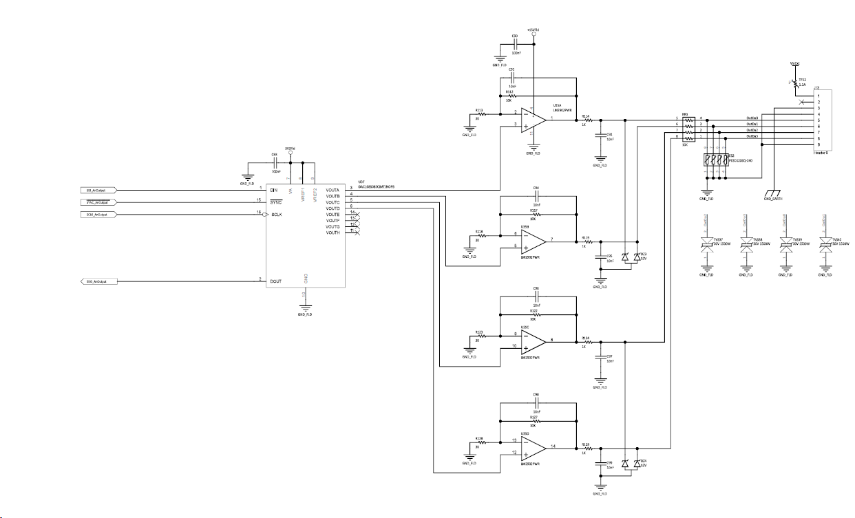

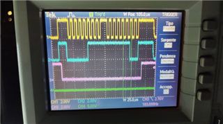

i've the following issue, the output is not able to execute commands, the output value is random. i attach the SPI image.
Yellow trace is CLK, Cyan trace is Din, Magenta trace is SYNC anf the Green trace is the output of zero channel, the programmaed value is 0x1ff = 6V. If i use the 0xA00F command the output value run in random mode. I haven't any idea about this issue.
The dac init sequence is the following: Broadcast command to zero, Mode to 100k for the channels 4, 5, 6, 7 and WTM mode enabled. Thanks in advance for your support.
