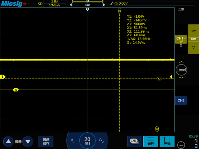

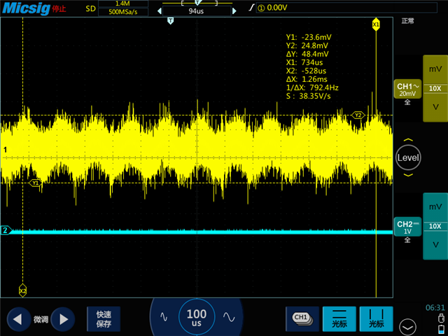

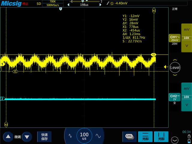

When using the pacing function of ADS1198, there will be a superimposed sine wave signal. Please help analyze the reason, and the waveform is shown below:
The output waveform of VACP2 is as follows:
Thanks!

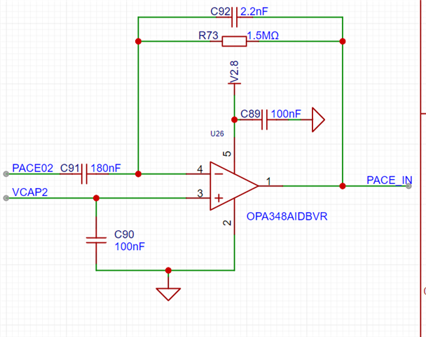

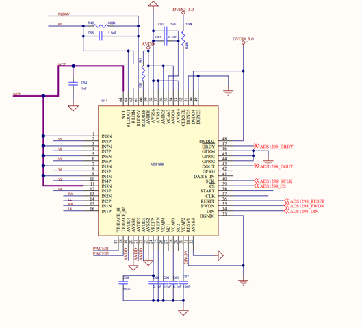

Please share schematics, register configuration settings for further debug.
What is the frequency of the sine wave?
Hi Praveen,
The sine wave frequency is 8kHz, and the schematic diagram is shown below. Please help analyze the reason. Thanks!
The model in the schematic has not been updated. The correct model is ADS1198. Please help analyze the reason?
