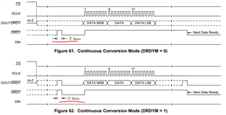

    It is said that in normal mode continuous conversion mode, the first conversion starts 210*Tclk after the end of the SPI start message, but there is no mention of a delay between the end of a sample measurement and the DRDY signal, is it below Tclk?
    The timing diagram in in section 8.5.4 shows that there is a 2*Tclk delay in the DRDY signal.

    Thanks for your answer, I'm actually trying to differentiate what you call "modulator running" (my "time during which the measurement is done") and "conversion time" (the values on table 11). I do understand that this badly defined "conversion time" is higher in single-shot compared to continuous, since in continuous mode "conversion time" and "modulator running" are the same but in single-shot there must be some starting/ending actions. My concern is whether or not the "modulator running" time is the same in signle-shot and continuous mode, which I cannot find explicitly written.
    I understand these Fig.61/62 as saying "If DRDY was already low, it will pulse for 2*Tclk"; I do not see any indication as to when the start of these "2*Tclk" occurs in relation to the end of the "modulator running" period.

    DRDY indicates when a new conversion result is ready for retrieval. When DRDY falls low, new conversion data are ready. DRDY transitions back high on the next SCLK rising edge. When no data are read during continuous conversion mode, DRDY remains low but pulses high for a duration of 2 · t(MOD) prior to the next DRDY falling edge. The DRDY pin is always actively driven, even when CS is high.

    Could you get back on the timing question about the delay before getting the DRDY rising edge (if DRDY is already low)?
    In other words, what is the delay between the end of the conversion and the DRDY rising edge?
    Conversion data is ready when DRDY falls low, not when DRDY transitions high.
    DRDY will then transition back to high on the next SCLK rising edge.
    This is stated in the data sheet:
    During continuous mode, data is ready when DRDY falls low, not on the rising edge. DRDY will transition to high 2*t(MOD) before data is ready, and DRDY transitioning back to low is what indicates data is ready.
    As stated DRDY will transition back to high after a data ready on the next SCLK rising edge, this is unrelated to the modulator clock.
    In Continuous conversion mode DRDY will transition high 2*Tclk before data is ready, and then transition back to low when data is ready.
    Not really sure what else you are looking for here.

    In normal and duty-cycle mode the sampling is done based on the modulator clock speed which is fclk/16.  In turbo mode it is fclk/8.  The conversion completes and the result is computed and placed into the output buffer of the ADS1220 during the update period prior to the falling edge of DRDY. In datasheet section 8.5.1.3, there is a reference to the update period which is 2*tmod.  So from the falling edge of DRDY, the conversion has completed 2*tmod prior to that.  In the case of continuous mode, the next conversion has already started during the update period.  That is why there is no additional delay except for the first conversion.

    Considering the computation delay, I read the datasheet as explaining that there is a pulse in case DRDY is already low, but I don't see any explicit link to a computation time; Can you confirm that it is exactly the computing time or is it an educated guess?

    This isn't specifically spelled out as computation time as several things are going on.  In the section I referenced before (8.5.1.3) regarding DRDY it mentions where the pulse goes high for 2*tmod (note modulator periods and not tclk periods).  It is during this time frame that the modulator data is processed through the digital filter and the result posted into the output register.  Valid data is ready to be read from the device on the falling edge of DRDY.  You do not want to try and read the conversion data during this 2*tmod period as the result will be invalid while it is being posted.

    This is exactly my use case, my sensor requires pre-sampling actions and I'm using the DRDY for datation and synchronisation, hence my need to precisely understand the sampling time and sync in relation to DRDY. Knowing that the sampling end to DRDY delay is within 2*tmod is enough for me.
