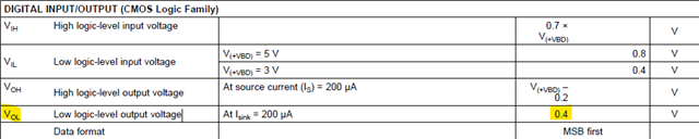

Kindly check the values of Vol (Low logic-level output voltage)
Instead of maximum value mentioned in minimum value

The low voltage output of the ADS7952 is from 0 to 400mV (worst case).
That would be the 400mV number. - just depends on your perspective. Min of 400mV with MAX of 0V for Vol. Are you having production issues with this voltage level or just curious about the datasheet numbers?
