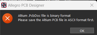

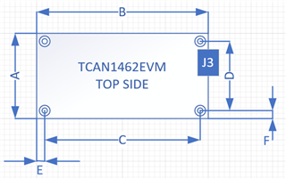

Hi, i need dimension and mounting hole position for build the mechanical plate.
Robert
Robert,
Are you trying to rebuild the board? I've attached the project files for this EVM to this post. Please let me know if this will work.
INT164A (9-23-2021 4-24-19 PM).zip
Eric Hackett
Thanks, What software are you using for generating those files?
Robert
btw i am using cadence allegro.
It does not work.
Could you send me those data:
I need domensions: A-F
Robert
Robert,
A - 72.2 mm
B - 115.7 mm
C - 106.8 mm
D - 63.3 mm
E - 4.4 mm
F - 4.4 mm
Please let us know if you have any other questions.
