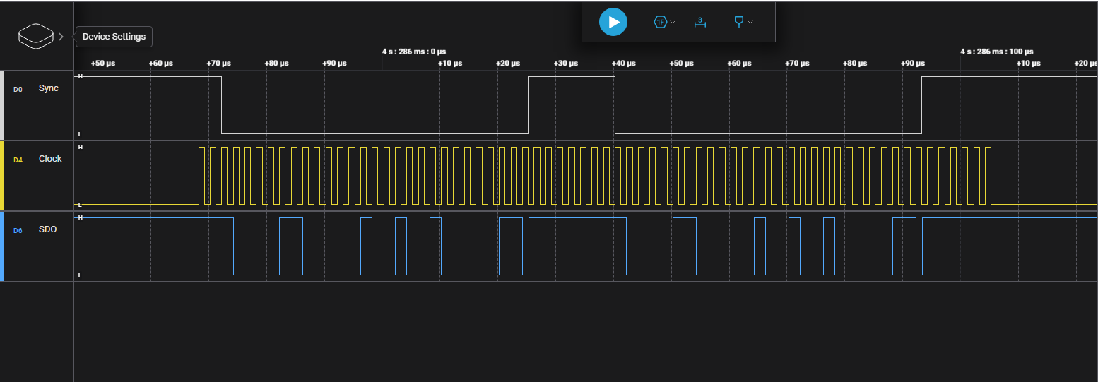

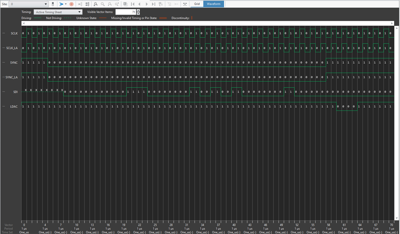

    We are trying to read back the register values using commands on SDO line, first we sent 0x030A84 on SDI line. then we sent 0x830000 on SDI line so that we could read back the values of 03 register, but we are not getting expected values. please find below images for same.
    -> Writing 0xA84 to 03
    -> Writing 0x830000 (for reading register 3)
    -> Captured SDO, SYNC and SCLK on logic analyzer
  • Hi Kiran,
    Your SPI frame is not correct and has following issue -
    1. Number of clocks are more than 24 (=~26) - not okay
    2. Your SDIN data is not latching on the clock falling edge, it's on the clock rise edge - not okay
    For DAC61402, SPI frame should have only 24 clocks and SDIN data should be latched/clocked on falling edge of SCLK line.
    Please read the detailed explanation from the DAC61402 data-sheet about the timing requirements in the sections mentioned below -
    7.12 Timing Diagrams
    8.5 Programming >> 8.5.1 Stand-Alone Operation
    Sanjay
