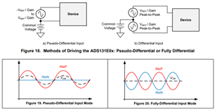

    Common-mode volage is defined as Vcm = (Vp + Vn) / 2 you can think of it as the average of the voltages applied to the input pins.
    If you were to tie AINN to GND or AVSS and a sine wave to AINP, the common mode voltage Vcm would be a sinusoidal as well that's in between the voltages applied to AINP and AINN. This would be a pseudo-differential signal. Below is an example:
    Maybe there is a misunderstanding when you mention using AVSS as the common-mode voltage.
    If Vcm = -2.5V (AVSS), applying a Vdiff of +/-2V would mean you are trying to measure a signal that between -0.5V and -4.5V, this would be outside the +2.5V to -2.5V of your supplies.
    The purpose of the capacitors should be to serve as anti-aliasing filters, something like this:
    The differential capacitor should be sized 10 times the common-mode capacitor. This sets the differential mode cutoff frequency about 20 times lower than the common-mode cutoff frequency. This prevents common-mode noise from being converted into differential noise due to component tolerances.

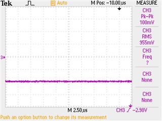

    Here is an approximate +1V signal from AIN0 to AIN1:
    The output codes from the ADC for the signal above are what we would expect, 0x2177D7. Which would roughly be 1.282V.

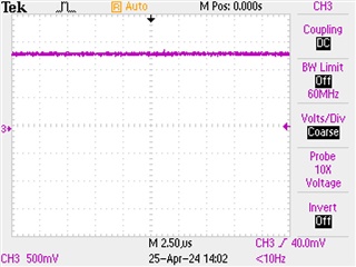

    Here is an approximate -1V signal from AIN0 to AIN1:
    The ADC reports 0x000000 for the signal above and AVSS goes from -2.49V to -4.53V.
    I find this very confusing and the only mechanism I have been able to consider is the ESD diodes are activating.

    Thank you for providing these captures.
    You are showing the differential voltage between the two input pins in the scope captures (AIN0-AIN1), but the voltages may be floating if they aren't being referenced to anything.
    Would you be able to show the voltage at the AIN0 pin with respect to GND, and the Voltage at the AIN1 pin with respect to GND separately?
    The absolute voltages at each of the input pins should be in-between -2.5V and +2.5V (your analog supplies).
    For example, if the absolute voltage with respect to ground at AIN1 is -2.5V, and the absolute voltage at AIN0 is -1.5V, Vdiff (AIN0-AIN1) would be = +1V, and your output code (~0x2177D7) and scope capture from AIN0(+) to AIN1(-) would show this. This would be valid since the absolute voltages at both input pins with respect to GND are within your supplies (-2.5V to +2.5V).
    However, if the absolute voltage at AIN1 is -2.5V, having a Vdiff of -1V would mean that the absolute voltage at AIN0 would be at -3.5V. [ Vdiff = AIN0 - AIN1 = (-3.5V) - (-2.5V) = -1V ]. Your scope measurement between AIN0 and AIN1 would show -1V, but the actual absolute voltages at the input pins would be outside of the recommended operating range (-2.5V to +2.5V) and this could damage the device or cause unknown behavior.
    Not completely sure if that is what is happening here, but it seems like that could be what the problem is.
