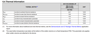

According to the datasheet, Thermal Information for CLGA and CCGA are same. Is this correct?
In my understanding, CCGA has solder columns while CLGA doesn't has solder columns. Is it OK that solder columns don't make any differences of thermal peformances?
