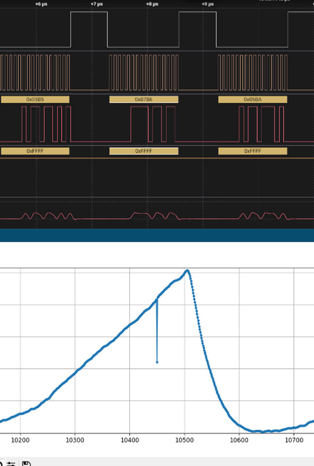

Figure 1: Wrong sample at 25 MHz SPI Clock
The figure below illustrates a faulty sample captured while the SPI clock was set to 12.5MHz. It displays the input data from a logic analyzer, which records at a rate of 500 million samples per second. The image shows the analog signal of the MISO-0 line, which exhibits activity. In contrast, the MISO-1 line remains consistently high, showing no variation or activity. This visual representation aids in understanding the dynamics of the signal and identifying the timing of the error.

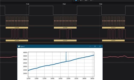

Figure 2: Wrong sample at 12.5 MHz SPI Clock

  • Hello Raffaele,
    Thank you for your post.
    Could you please share any register settings which are different than the power-on defaults? Have you confirmed the register settings are valid via a register read frame?
    Have you monitored the REFIO pin for any transient behavior? The default internal reference voltage (4.096 V) can be probed on the REFIO pin or nearby bypass capacitor.
    Just FYI - the device powers up in single-SDO mode, SPI 00. The logic analyzer SPI analyzer in the first image appears to be configured for SPI 01 as the arrows mark the capture edge to be falling edge. This should be changed to rising edge for mode 00.
    It may be helpful to closely observe the SDO pin on an oscilloscope for any transient behavior which may be filtered out by the logic analyzer. Check at the ADC output as well as at the host MISO pin.
    Ryan
    • Capturing (inside our receiver) takes place in the middle of the high sckl,
    • SDO Data is presented in SPI Mode as shown in Figure 7-27 of the Manual.
    • Only Register which is changed is the Range_SEL_REG to 1.25*Vreff
    We have 2 instances of this ADC on our board with the same schematic, however we have noticed this issue only with one of them.
  • Hi Rafaele,
    Thanks for clarifying. Would you be able to swap the two devices and see if the issue follows the IC?
    Ryan
  • Hi Ryan,
    Thanks for your answer. We have tried swapping out the ADC with a new one and the problem persists. It is not limited to one specific IC.
