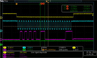

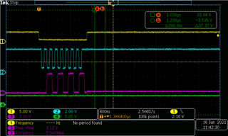

    (Ans)There are 3 behaviors on IOUT when the issue occurs, unstable(up/down) zero point, dropping gain or both of these.  The issue can occur in just 30-60 minutes, but it usually does in 3-5 hours.  The communication cycle is 50 times per second.  In normal case, it is expected to have 24 clocks to access registers as shown below left, but if the issue occurs, the clock stops working in the middle as shown below right when the interrupt is triggered.

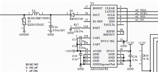

    Can the customer provide a schematic of their circuit?

    1. The following shows the peripherals of the DAC8750.  It shows AD5420 though.

    In the previously provided pictures, why is the SCLK stopping early? The customer's microcontroller should be providing a valid 24 bit write command.
    The DAC doesn't have control of the SCLK and SDIN signals.
    The customer could also use CRC frame error checking to ensure the integrity of the SPI data.

    They're aware of the behavior that the MCU stops clocking in the middle.  The issue here is that the competitor's DAC ignores the input in such cases, but DAC8750 seems to get the data and changes the registers affecting the Iout.  They see data for 8-clocks and stops for a while and resumes again for the rest of the 16-clocks.  Or 16 clocks following by 8 clocks.  Are you aware that it stops in the middle with LATCH=Hi and resumes after a while and it can change DAC8750 registers?  Does DAC8750 need to get data of 24-clocks in one time without changing LATCH=Hi in the middle?  How can they avoid the issue based on the fact that their system may stop sending data in the middle and resume after a while?
    Yoshikazu Kawasaki
  • Hi Yoshikazu-san,
    Section 8.5.1.4 of the Datasheet (page 31) mentions that not having the correct amount of SCLK cycles will result in incorrect data being programmed into the registers.
    Section 8.5.1.1 mentions that the host must issue 24 bits before the rising edge of LATCH, meaning all 24 bits of data must be during a single low period of LATCH.
    This device doesn't detect improper amounts of SCLK cycles.
    Many of the newer DACs will not accept faulty commands with less than the required SCLK cycles.
