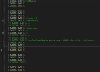

adc12dj5200 configuration:
After configuring three chips according to the above file, I read back the value of register 0x038 in JESD204b core in FPGA, which is 0x10001, and the value of 0x03c is eeee, indicating that the link of jesd204b has been established normally. But when I read back register 0x208 in adc12dj5200, the value I read back is 0x64, which indicates that the phase of LMCF and sysref is not aligned.Can you help me solve this problem?

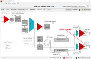

  • Thank you very much for your answer. I have found the problem now that the ROUTB of LMX2594 did not output the SYSREF signal of 31.25MHz.I found that when I set RoutB to DCLK as RoutA, it has output, but when I set Routb to sysref, there is no output. Can you help me find the reason why LMX2594 does not output RoutB according to the LMX2594 configuration provided above?
    In addition, do you mentioned "There are two methods of sysref calibration, sysref windowing and automatic sysref calibration" means that these two ways, just choose one? In other words, if I chose Sysref Windowing Mode (read back registers 0x2c, 0x2d, ​​and 0x2e to configure 0x29), then I don't need to use Automatic Sysref Calibration mode?
    Xiaxin
    If you are using the ADC GUI to program the evm the RF out B of the lmx2594 is by default powered down, to turn it on you can go to the LMX2594 tab and uncheck the power down checkbox.

  • Hello Eric,
    I found that when the value of register 0x208 in adc12dj5200 is 0x64, I can obtain the waveform. May I ask what is going on? I don't know if the waveform obtained in this way is correct.
    regards,
  • Hello Xiaxin,
    0x64 is a valid mode of operating for the ADC. I am confused why you think this is invalid? Can you please elaborate on your question a little more?
