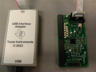

With the USB-to-GPIO2 adapter and the UCD3138 components in hand, what's the process for flashing the firmware onto the UCD? Is it possible to do so without an XDS110 adapter?

Hello Tasmiya,
I have already answered your question from your previous E2E post on how to get started with the UCD3138 control card. Please refer to that answer. Also, please watch the UCD training lab videos. They walk you through exactly how to get started with the UCD3138 control card.
Previous E2E post: https://e2e.ti.com/support/tools/code-composer-studio-group/ccs/f/code-composer-studio-forum/1352388/ucd3138-ucd-3138cc64evm-030

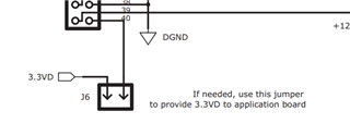

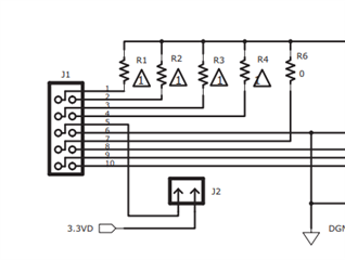

Hello Tasmiya,
I do not understand what your goal is and the purpose of the DC power supply is for. Power to the UCD control card is either supplied by the PMBus or the I/O connector on pin 40. Use a jumper to toggle between the two voltage sources (short J2 for PMBus source and J6 for I/O source).
You can configure a GPIO by toggling the pin's GPIO bit. Please see section 9.9 on page 364 of the UCD 31xx TRM: https://www.ti.com/lit/ug/sniu028d/sniu028d.pdf
