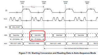

When I set the ADS7067 to Auto sequence mode, set the "SEQ_START" bit to 1,
and set "AUTO_SEQ_CH_SEL" TO 0X00(all 7 channels set to Analog in);
I can't get  any data from all 7 channels, it's always 0xFF.
Datasheet Chapter 7.4.4 suggests the output data format of SDO should be 16 bit or 20 bit,
but Table 7-15  shows that SDO should  only has 12 clocks, even it is a 16bit ADC.
So what exactly is the auto-sequence reading command?

  • Ryan, thank you for your reply!
    Sorry, I  typed the wrong register name;
    I meant  I set the register "PIN_CFG" to 0X00 (config all 7 channels to Analog in),
    and set "AUTO_SEQ_CH_SEL"  to 0XFF (all 7 channels enabled in scanning sequence).
    I also set the SEQ_MODE of "SEQUENCE_CFG" to 01b ( Select Auto Sequence mode),
    and set the" SEQ_START" bit of  "SEQUENCE_CFG" to 1b (start channel sequencing ) just before
    reading ADC values by transmitting 8 data frames of 16bit low (0x00,0x00) on SDI.
    Besides,   I disable averaging filter, input/output CRC,  and Channel ID/ Status Flag,
    so that the data frame size is 16  bits.
    But I still  get  wrong ADC readings.
    Is there still anything  I missed?
  • Hi Joe,
    Thanks for clarifying. Those register settings and the initialization sequence look correct.
    Referring to Table 7-4, you may still need to send 24 SCLKs, even though CRC, averaging, and STATUS words are all disabled. Can you try extending the frame to send 3 bytes of 0x00 on SDI? I might also recommend enabling the channel ID status just for now to ensure that the internal multiplexer is cycling through the channels as expected.
    Can you share a schematic so we can review what all is connected to the I/O lines?
    Ryan
  • Hi Ryan,
    I figure it out!
    My register settings are all correct, and the 16bit 0x00 command also works.
    The real issue is that I can't distinguish which data frame corresponds to which channel since I did not append the 4-bit Channel ID to the data frame.
    That's why I thought I had read a wrong value.
    Besides, I think the term "12 clocks" shown in Table 7-15 actually means "Read 12-bit data and discard it. ", which is not mentioned in the datasheet.
    This 12-bit  data was also misidentified as a reading from one of the eight channels.
    Therefore, I followed your advice to send 3 bytes of 0x00, and enable the 4-bit Channel ID.
    Read and discard the 12-bit data just after setting "SEQ_START" bit to 1.
    Now all 8 channels' readings are correct.
    Thank you!
