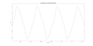

I have to develop a system for EMG acquisition, I am using the ADS1299EEG FE Rev A evaluation board. My reference electrode is placed between the signal electrodes, about 10 mm of distance between one electrode and the other.  In order to better understand how the system works, I would like to ask you some questions:
  1. Why does the noise signal that I catch have a DC component? Could you explain the physical reason for this (any model, paper, phenomenological motivation)? If I short the input pin (internally or externally), I measure correctly the expected offset relatively to the gain that I am using.
    Sometime I observe also a drift of the signal.

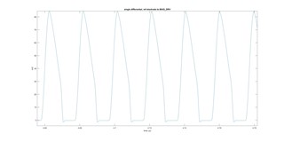

2. Why if the reference electrode is connected to GND, the signal is clipped? Something with the bias current on INxP and/or INxN of the low noise PGA?

    About question 2, the reason could be a difference in the GND of my own body respect that of the acquisition system? When this GNDs are connected in a DC way, could happen that the signal read is negative respect this GND and the ADS1299 clips the signal on its low limit?

    1. The offset voltage you observe is caused by leakage current on the input pins and the impedances in the signal path. Neither the leakage current or circuit impedance will be perfectly matched due to drift, electrode impedance mismatch, PCB parasitics, etc. Some offset calibration or digital filtering would be necessary in order to remove it from the measurement. Generally, a few millivolts of offset is not an issue since the signals of interest are AC.
    2. The BIAS electrode should be used to establish a mid-supply common-mode voltage on the body equal to (AVDD+AVSS)/2. The voltage on each input pin is limited by the supply voltage.
