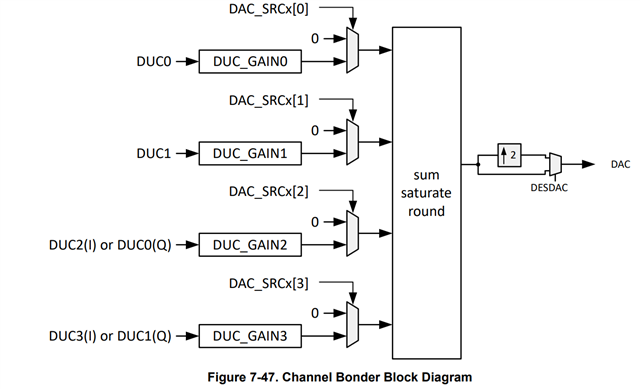

Another question about these converters is regarding the relationship between the digital signals in phase and quadrature, and the analog output signals. In one converter, I noticed that there is the possibility for 4 pairs of digital signals (CH0_I, CH0_Q, CH1_I, CH1_Q, CH2_I, CH2_Q, CH3_I, and CH3_Q) to be transported by the JESD204B/C LANES, however, there are only 2 analog conversion outputs (DACOUTA+, DACOUTA-, DACOUTB+, and DACOUTB-). How does the digital signal relate to the analog signal? For example, do channels CH0_I and CH0_Q control the phase and amplitude of the analog output DACOUTA+.
  • Luiz,
    Speaking for the DAC39RS12, this device has something called the "channel bonder" on it. This allows any I/Q stream to go to any DAC (for the RF12 there are two DAC channels for the RFS12 there is one). In a JMODE like JMODE3 one could send all four I/Q signals to a single DAC output, allowing one to have multiple modulated signals to be present on the single DAC output. The DUC_GAIN field can digitally attenuate each DUC by -6 or -12dB to allow multiple I/Q streams to go to a signal DAC without digital saturation. In addition, if one only has a single I/Q stream going into the JESD interface they can map it to both DAC outputs (on the DAC39RF12 dual channel device).

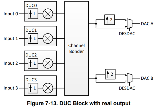

  • Masa,
    A stream is a stream of digital data. In real modoes a single stream is sent to either DACA or DACB. In complex data modes I accounts for one stream and Q the other. In complex data modes each DAC can output up to 4 I/Q data streams at once via. the channel bonder.
    Your statement about JMODE1 is correct. If the interpolation is set to 1 (real mode) and a single data stream is being used, only 8 lanes will be used by the DAC. the other 8 lanes will not be used. One could also send 2 real data streams via JMODE1 and use all 16 lanes. This would allow  DACA and DACB to have their own streams.
