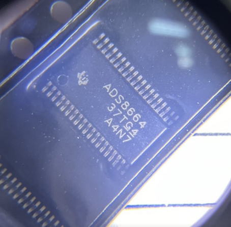

I use the ADS8664 to reading the voltage ,sometime the ADC freeze after power on

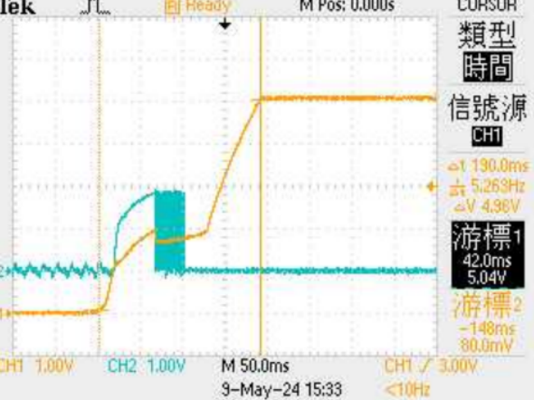

hi Tom
Ch1: is VCC POWER for ADS8664, CH2 is C/S pin
After many Test, If I Apply the glitch for C/S Pin before the power build, the ADC will freeze, HW Reset or firmware Reset still can't work , the reading is freeze
C/S pin is by the photocoupler, so will general the Glitch
Hi Alex,
Is the /CS line 'chattering' between 2V and ground in that area just before the fifth division? If that is the case, then I suspect you are corrupting the registers while the power is still trying to turn on (note the dip in the yellow trace vs. /CS).
There is nothing in the datasheet about the /CS pin bouncing around. Or is there something else you are looking for?

HI Tom
/PD/RST Toggling, but ADC still freeze, could you replicate this issue in TI?
Hi Alex,
Can you tell me if it is really the /CS bouncing or is it having analog input voltage present before power is applied that is causing your problems?
Yes to voltage or to /CS or both? If voltage, what level/ch do you have applied?
HI Tom
main issue is the ADC freeze, when the analog input voltage present before power is applied , or CS/ bouncing Before power applied,
in this situation. i can't reboot the ADC Whatever the HW reset or Firmware Reset
I won't be able to easily reproduce the /CS bounce, but if you let me know what voltages you have on the analog inputs I can try that.
