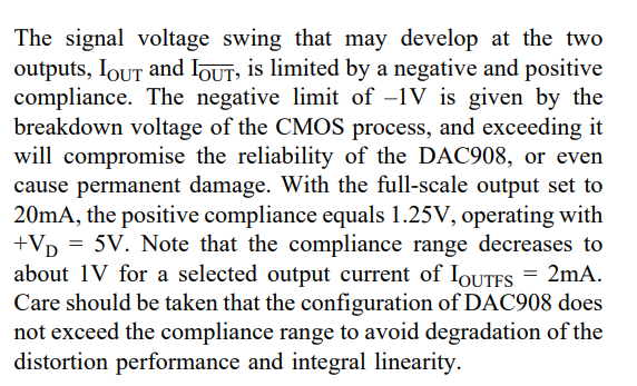

For DAC908, in datasheet its mentioned that Output Compliance Range as 1.25V and full scale O/P range is 20mA. Does that mean the O/P current will be limited at 1.25V?
We are using this IC for 0 to 5V trail. Will it work with Output Compliance Range as 1.25V or the O/P will be limited to 5V.
