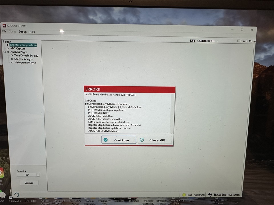

After I connected the 6V power, then USB power, open the EVM app on the PC, and this message pop up. Anyone know how to fix this.

Can you screenshot the full error message and post to the forum? I have not seen this error before.

Hello Daran,
I have asked our software team to take a look at this; please give me a few days to investigate.
Also, it is possible that not all software components were properly installed. I suggest installing a different EVM GUI which uses the same driver to see if this corrects the problem.
1. Install ADS127L11EVM-PDK-GUI software. This will load all necessary drivers for both the ADS127L11EVM and the ADS127L18EVM.
2. Re-install the ADS127L18EVM-PDK-GUI software. After connecting 6V power and the USB cable, run the L18 GUI software.
Again, this may not correct the issue, but it will not take very long to see if this corrects the problem.

Hello Daran,
If installing the different EVM software for the drivers does not work, you may want to try using a different USB cable or USB port on your PC. The team has seen similar issues when the PHI data capture board does not power-up correctly from the USB connection.

Hi Keith
I installed ADS127L11 GUI sW and it fixed the issue. I think the ADS127L18 SW miss some driver installation. I did it on three labtop so it can't be HW related.

Hi Daran,
Thanks for the feedback. I agree that this must be a driver issue. We will correct this and get an updated version of the GUI published.
