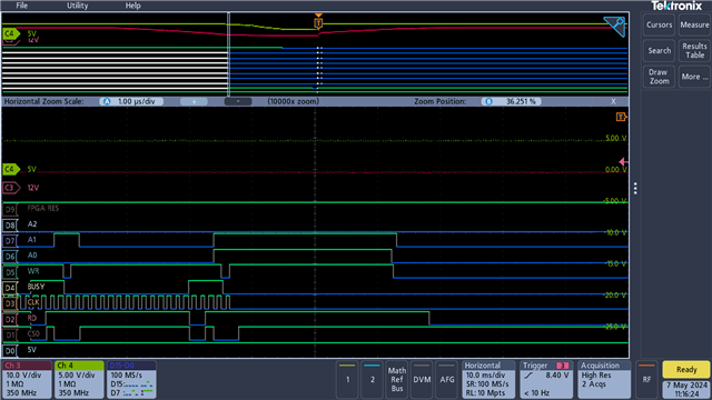

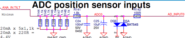

I'm having problems with the ADS7852 going into some latched up mode.
If a glitch in the 5V power supply, that resets the main processor while it is setting the ADC to a new channel, the ADC keeps the BUSY signal low.
After the power is up to 5V again and the processor is online again, the ADC still keeps the BUSY line low. It can only be resolved If the unit is properly shut down and 5V power goes all the way to zero.
My question is: Can the ADC be brought out of this again somehow without powering completely down the device?
