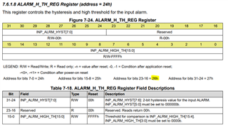

  • The WRITE commands still doesn't quite makes sense to me.
    Let's say I want to write to the ALARM_H_TH_REG Register at addres 0x24 (0b0010 0100)
    Let's say I want to put 0xFF in INP_ALRM_HYST and 0x00FF in INP_ALRM_HIGH_TH.
    If I can only write 16 bits at a time, I'll have to do two writes.
    • The <9-bit address> will be 0x024 (0b0 0010 0100)
    • The <16-bit data> will be in bith cases 0x00FF (0b 0000 0000 1111 1111)
    So I how do I select which part of the register to write to?
    (I.e. because we can only write 8 or 16-bits at a time - we need a way to select where in the 32-bit register those 8 or 16 bits are written).
    Are there any examples? That may help me under stand this.
  • Hi Ben,
    You would have to write a 16 bit data write command to address 26h to set INP_ALRM_HYST, and the another 16 bit data write command to 24h to set INP_ALRM_HIGH_TH. You cannot write to 25h or 27h, as the address must be even.
    For example, to set 0xFF in INP_ALRM_HYST, you could do:
    1101000 <write> 0 0010 0110 <9 bit address 26h> 1111 1111 0000 0000 <FF00h>
    And repeat with address 24h to set 00FF in INP_ALRM_HIGH_TH.
