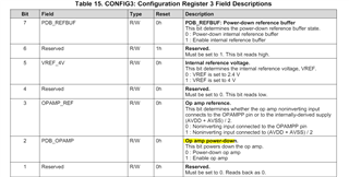

 In the ADS131E08 datasheet, I saw this on page 49: "Power down the Bias amplifier if unused and float OPAMPOUT and OPAMPN. Tie OPAMPP directly to AVSS or leave floating if unused."
In my schematic, I have OPAMPOUT, OPAMPN, OPAMPP floating and disconnected.
My question is how we actually power down the bias amplifier to save even more power.
Our software engineer for this project looked through the datasheet and couldn’t find what registers control the bias amplifier. Can you please let us know?
