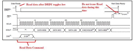

    4.What is the meaning of the following statement in datasheet Page 31 : "The read data command must be sent at least 20 f CLK cycles before the DRDY falling edge or the data are incorrect. Do not the read data command during this time". Is this the update time given on Page 30 in Fig 60?

    4. What is the meaning of the following statement in datasheet Page 31 : "The read data command must be sent at least 20 f CLK cycles before the DRDY falling edge or the data are incorrect. Do not the read data command during this time". Is this the update time given on Page 30 in Fig 60?
    Yes, you are correct, during this time the internal conversion result register is updated during this time and data is being shifted; therefore, if you send RDATA command less than 20 fclk cycles before DRDY low, the data will be corrupt.  The procedure recommended is to monitor DRDY and send the RDATA command right after DRDY goes low to avoid this situation; or you may always go back to RDATAC mode after configuring the registers.
    Your reply to this question was: Yes, you are correct, during this time the internal conversion result register is updated during this time and data is being shifted; therefore, if you send RDATA command less than 20 fclk cycles before DRDY low, the data will be corrupt.  The procedure recommended is to monitor DRDY and send the RDATA command right after DRDY goes low to avoid this situation; or you may always go back to RDATAC mode after configuring the registers.
    However,apart from the grammatical error, dont you think the statement made in the datasheet and your reply contradict each other because the datasheet says that the read data command needs to be issued 20 fclk BEFORE the DRDY bit goes low. You are telling me to issue it after the DRDY bit goes low. I am using stop continuous mode to read data in Pulse conversion.
