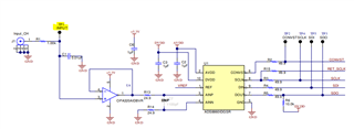

    Thanks for your question! What is the output voltage range of the accelerometer? The input signal range of the ADS8860 is about 0V to 5V, so if the accelerometer output is within this range and 1MSPS sampling is what you're looking for, it should be compatible. Regarding other components, this would be up to you and your application. Referring to the accelerometer user's guide may help.

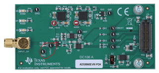

    I noticed the input for the ADS8860EVM-PDK is via a SMA connecter. My accelerometer connects via 6 pins as shown in the image below.
    VDD: power supply pin (3.3V) for the ADXL1001 accelerometer.
    GND: ground pin and should be connected to the system ground.
    V_out: analog output signal of the accelerometer.
    Could you advise on how I can connect the Accelerometer to the ADS8860EVM-PDK?"

  • Hi Marvin,
    You could use the input and GND test points on the board to connect the input:
    This EVM seems to only have a 5V rail, so you'd need to supply an external 3.3V for the accelerometer VDD rail.
    Samiha
