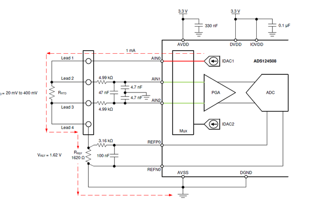

  • We have used TI guideline for PT100 = 4 wires low side reference and as mentioned above also used protection components.

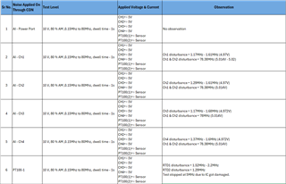

    We got below issue in CI testing.
    Please suggest how could we do through by adding more protection components or through any software algorithm or giving programmable delay for removing aliasing effect?
    Thanks in advance.

    We have considered your application note and same things are being applied in our design. We have passed Surge and EFT but face challenge in Conducted immunity test.
    Due to confidentiality, I could not share schematic and layout files.

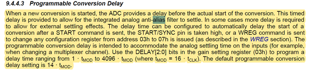

    Could you please share your thoughts that we may do through by adding more protection components or through any software algorithm or giving programmable delay for removing aliasing effect?
    Please refer below snaps for anti-aliasing filter settings. Could you please guide us on this for 4 channel aliasing effect solution(which is shown in above my chat disturbance between 1.17MHz to 1.6MHz)?
    One last question is that in ADS124S08 IC is having any Butterworth filter design inside the chip which can be coded through software? Is it true?

    The programmable conversion delay is primarily used when switching mux channels to prevent charge distribution from one set of channels to the next ones selected.  The mention of the integrated anti-aliasing filter is referring to the filter that reduces the noise of the internal switching frequencies.  It will do very little to any external noise.  See the circled sections below which are the filter components:
    The programmable conversion delay only takes place when switching mux channels when in continuous conversion mode, and when using single-shot mode and starting a conversion.
    The filter sections shown above are the only analog filtering components.  The ADS124S08 is an oversampling device where the analog input is converted to a modulator bit stream.  The modulator data is passed to a digital filter which process the data via a sinc or FIR filter depending on the configuration selected.

    In our application there is total 6 Ports ADC. 4 of them are used for measuring +/-10V and 2 ports for measuring temperature through 4 wires PT100 sensor which is shown in above block diagram. These data communicated through ADC's SPI to MCU
    These data are reding through our software web tool. Master devise and Analog measurement device communicated through RS485 device.
    As you said, it is possibly to solved through adding ferrite bead in series for the solution of +/-10V measurement. But in PT100 ports we are facing issue that noise are going into ADC and randomly values has been changed and then IC got damaged. It seems through current source channel or through reference REFP0/REFN0 noise is entering in ADC.
    Current source 1mA, ODR = 4K, Fc = 1.046K set through sinc filter.
    Our design is similar to below snaps for PT100. We have just added schottey diodes at current source path and MOVs and TVS placed at input paths to the earth, still noise is injected in ADC. While other +/-10V input ports are not injecting noise in ADC same protection has been at input side (MOVs and TVS). Could you please guide me on this?
    Please note that we are not using EM clamp for testing, we are using CDN device because as per IEC 61000-4-6 suggests CDN for noise injection for the Analog input port testing. We have too little power consumption of device in few mA. Should we use EM clamp for certification?

    As to the issue of damage to the device, the most likely place for this to occur is the IDAC output.  Any transient voltage applied to the pin where the IDAC current is coming out of the device must be limited to no more than +/-10mA.  Using a diode will only help in one direction of current flow.  Using TVS diodes will have a clamp voltage.  If the clamp voltage maximum is greater than the AVDD supply, then you must limit the current to prevent access to the IDAC pin.
    If you are using 1mA current and the reference resistor is 1.6k you may have some additional issues as the compliance voltage is 3.3V - 0.6V or 2.7V for the total voltage drop in the IDAC current path.  It is unclear how high the RTD temperature can go, so let's say it could go to the maximum temperature.  This would mean you could have compliance issues with any added diodes or resistance in the IDAC current path.
    One possible option would be to change the value of the reference resistor to 860 Ohms.  Then instead of the diode use a 1k Ohm series resistance.  The 1k resistance will limit current flow through the ESD structures in both positive and negative excursions.  The compliance voltage will be acceptable for the full range of the RTD resistance.  The downside is you would be limited to a gain of 1.
    Another option would be to lower the current to 500uA while again adding the series resistance.  The difference here is you could raise the series resistance to further limit transient current.
