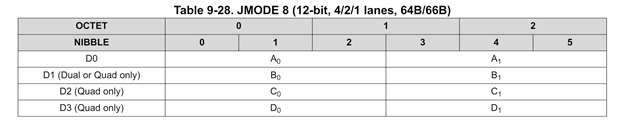

When working with JMODE 8( 64/66b) does the chosen four outputs maps as:
Lane 0 to D0(+,-) ,Lane 1 to D1(+,-),Lane 2 to D2(+,-) and Lane 3 to D3(+,-)?

Hello Giora,
Yes this is how the data is mapped in this mode, please see the datasheet for more details on the lane mapping as well as how the data gets packed.
