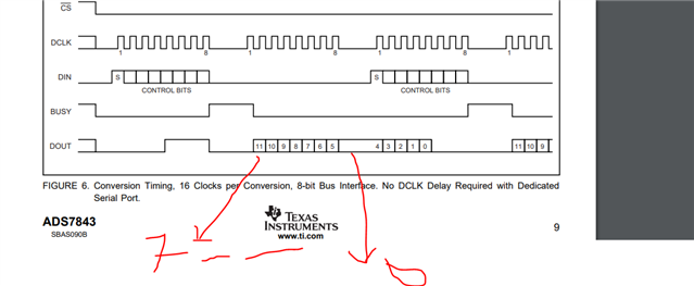

3. In FIGURE 5 on page 8 of the data sheet, is the DOUT output the data captured at the timing of tACQ just before that?
    At the end of tacq the acquisition of the analog sample is complete .
    4. According to TABLE IV on page 9 of the data sheet, if MODE is set to "1" (8bit Conversion), is it correct to understand that bits 3 to 0 of DOUT output "0"?
    Bit 7 comes first and then rest of bits down to 0.
