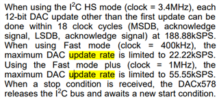

I had a question regarding the DAC7578. Can the output of the DAC be switched at higher frequencies (10kHz)?
Looking at the datasheet, the highest update rate is 188.88 kSPS so it should be able to output frequencies up to around 95 kHz. Would that be correct or am I overseeing something?
Thanks in advance.
