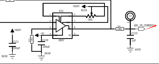

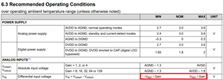

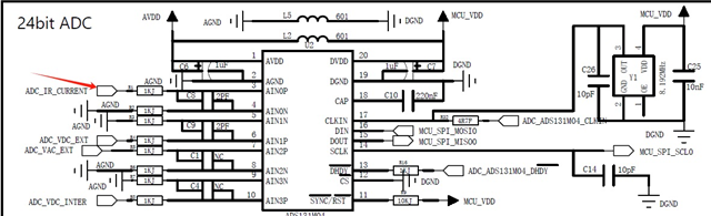

My customers are using ADS131M04 and facing a problem. When they manually increase the input voltage slightly over 1.2V and reach around 1.37V to 1.45V, the data output of M04 is not 7FFFFFh meaning that the input might be over input range. Instead, they read a 0.99V from the output data, which seems quite strange. But when they decreased the input voltage below 1.2V then the data is back to normal and correct input voltage can be read.

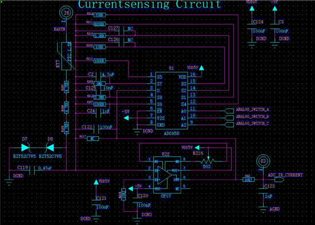

The schematic is as below, could you pls help giving some suggestions on why the data read is clamped at around 0.99V when input over the range.
