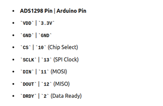

I am using ADS1298ECGFE-PKD BOARD. I have unplugged the MMBQ motherboard and working with the ads1298 board. The problem is that when I connect the ads1298 board to an Arduino, I am unable to read the device ID of the board, which stops me from using it. I am receiving 0x00. Do I need to adjust any jumper settings or do I need to make a code change? I've included my Arduino code and connections below; could you please assist me in fixing this?

/*this is pin configurations with Arduino*/

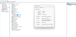

  • Hello Ryan
    Thank you for your response. Although I sent the SDATAC instruction before reading the data, the device ID is still not being read; instead, we are seeing the output 0x00 or 0xFF.
    Could you please let us know which jumper settings to set up in order to use it with Arduino? Another issue also emerged: as you can see in the image below, we are unable to obtain the device ID when we connect the ads1298 board to the MMBQ mother board and attempt to read data using software. we become stuck in read registers.
    The data rate change automatically 500SPS to 4000SPS and it got stuck there. After completion of it we get this type of error.
    can you please help us to solve this problem?
  • Hi Ajay,
    For interfacing the EVM daughterboard with Arduino, you will have to consult the schematics in the EVM User Guide and determine the necessary jumper settings and flywire connections required. The documentation for SPI timing, register map, and command definitions is all contained in the ADS1298 device data sheet.
    Does the above error message occur when connecting the MMB0 + ADS1298EVM in their default jumper settings? Can  you share a screenshot of the Device Manager window to show how the EVM is enumerating?
    Ryan
  • Yes, that problem happens when we connect MMB0 to ADS1298EVM using the default jumper configuration. As seen in the image below, we are able to identify devices in device manager.

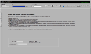

  • Hi Ajay,
    The EVM seems to be enumerating correctly. I would try the following:
    1. Power-down the MMB0+EVM by disconnecting the external 6V supply
    2. Disconnect USB from PC
    3. Close GUI
    4. Power-up EVM+MMB0
    5. Connect USB to PC
    6. Press and hold RESET on MMB0 (S3), then release.
    7. Start GUI
    The 7-segment display on the MMB0 should show a lowercase "b" after start-up. The GUI should be able to download the firmware automatically and display the Device ID and FW version as shown below:
    Ryan
