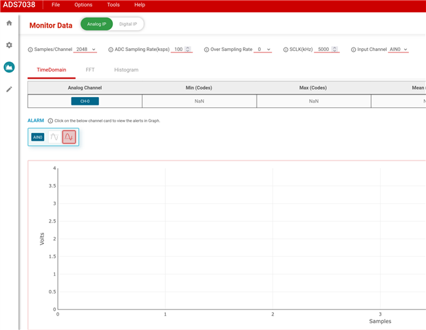

Hi all,
we got a ADS7038Q1EVM-PDK evaluation board.
After I have installed all the things - that I normally do not like to install - I got to open the Gui.
After starting and setup of the ADC (set as diescribed in the user manual), I cant see any analog signal on the screen.
If I read the analog registers holding the values I can see the conversion result changing, depending on the signal I connect.
I set the allert LED channel AN7 to channel AN0 and its on (threshhold levels are set).
So it seems the system reacts correct, but not waveform is displayed.
Please give me advice what is wrong.
Regards Matthias
  • Hi Matthias,
    This seems to be a problem with the program rather than your setup. Our first recommendation would be to simply reload the application. What browser are you currently using to launch the GUI? You could try switching to another browser. Please let me know if either of these methods work, or if this yields the same result.
